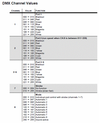

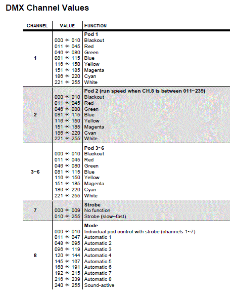

So I recently got a Chauvet Sweeper LED, and I like what it can do in auto mode, but I would love to have more controll over it. I tried making a fixture file for it, and I have basic controll, but I can't seem to get down the finer points. If someone has the time or ability to make a file for it, I would greatly appreciate it.
Thanks.

Hej DJPhizz
It is not a big deal to make that fixture.
As I understand you have tried to make a fixture with Fixture Cteator.
If not then go to the "wiki" there are all the info and tutorial you need.
Place the 6 pod function in the Macro Tab.
Place a number icon [1] as the first and then the 8 color icons and finally a blank icon.
It is not necessary to give the two not use icon any values.
Repeat this for all 6 pods.
Use the "Show in" function and select "Gobo".
Strobe: well that goes into the Strobe control in the config tab
And on "1st Gobo wheel" channel 8 with 10 gobos
The "1.st Gobo rot" control can then be set to Channel 2.
When these Automatics are used then the speed control will be on the rotation fader.
