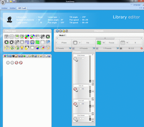

Hej folks
I need some help on the oby 5 fixture.

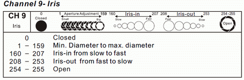

I found that the Iris control was made with a "shutter - close", "Linear" ... ending with a "shutter - open"
The fixture don't working control on the iris control.
So I looked into the MAC2000 profiler I can see it is made in an other way.
I now have a iris control that are basically working on the iris except from the last step "Open"
It only opens iris half compared with the opening at 159.
I have set the property for the last part to 99% to 100%
How do I get the last step 254 - 255 to work.
