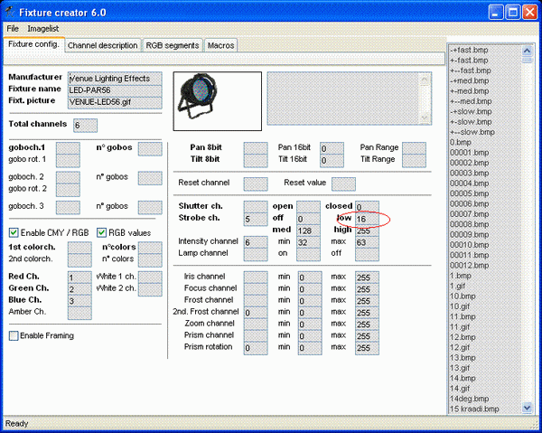

I'm not sure what model of Freestyler I'm using. But the lights are Venue LED Par 56 and I'm using Enttec Open USB. I can not get them to stop strobing. I can make them strobe fast, change colors, blackout, etc. but I just can't get them to stop strobing. It's really irritating.
Can anyone please help me? :( I'm stumped.

I think there is an error in the fixture driver.
Have been reading the manual.
I think "Strobe ch", 5: "low" are to be 0.
Start "Fixture Creator" and open Venue LED PAR56.
Change low from 16 to 0.
You need to restart Freestyler after the modification.
Try this and see if it helps. :D

everything seems to be correct the Off value = 0, you can stop the strobe by pressing Closed or Open
you can also open the add/remove window right click with the mouse on the Fixture list and press "Refresh list"

Hej Spirit
I have had the same problem in an other fixture.
If you are using the shutter channel for switching strobe to "no ligth" or to "full light" then I can see that there is no channel defined.
Am I then to enter a channel no for the shutter cahnnel ("5") and an "open" and "closed" value.
I can see, on the image" that no value are entered.
On the other hand I can see that "high" is 255 which correspond to open
Think I am to find some HW. and try it out.

Hej again Spirit.
I have just been looking on it again.
Is this correct.
If I want to stop the strobe then I have to press "Close" for the shutter and then "Open" to get normal ligth on again.
The "Close" will set intensity and strobe to the off value.
And "Open" will set intesity only, to the on value.
This means that stoping the strobe is a two button sequence.
@ nooblightingguy.
The fader panel in the right side of the window if you open this then you can see what values the channels have after you have pressed the buttons and if one is wrong you can manualy change it here until you figure out how the fixture works.
It can be used as a fast / panik solution. :)

set shutter channel to 5 and open value to 0... now you should deactivate strobe with 1 click on "Open".
Thats how i use to set up my fixture files and deactivate strobe.
Remark: i have not used the newest FS and FC (Fixture Creator) so i'm not 100 % sure it will do the trick but it have worked for me before
