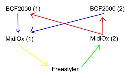

- Spirit
- Posts: 1421
- Joined: 10 Jul 2010, 20:55
- FreeStyler Version: 3.5.9
Re: Little question about BCF
First of al you need to download the Drivers for the BCF
then you need to plugin both the usb cables into your pc.
Install MidiOx and Midi Yoke (Midi Yoke is a Virtual Midi Cable)
now you open MidiOx and set "midi in" to Bcf2000 1 & 2
And "midi out" to "Midi Yoke1"
now you open Freestyler go to the Midi options and set "Midi in" to "Midi Yoke1"
Blue and red: Usb wire
Yellow : Midi Yoke1
Green : Midi Yoke2
Also a good thing to know is that the .Sys file on the Bcf's are the Same so if you drag the first fader of the first Bcf it will give the same "Note" as the second Bcf. so you need to make 2 differnt .sys Files.
I'm not sure if it's going to work Never tried it, but it seems to be the most logic way for me.
