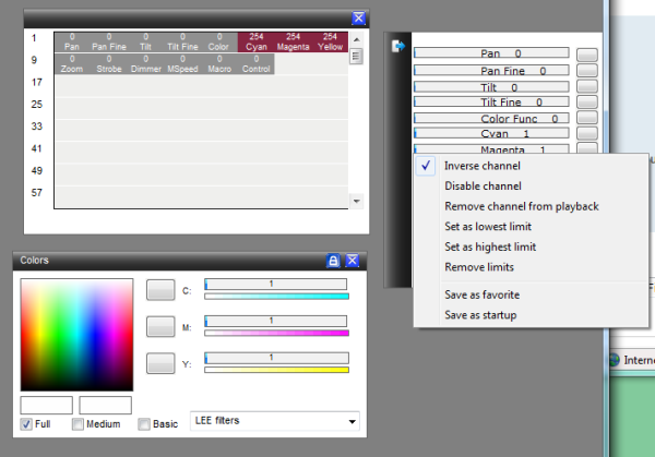

My Problem is ,, I use Stage Scan and HighEnd Studio Color
If I want the white color need on 100% on my CMY Channels..... how can I Inverse the output on the CMY Channels ??????
Thank you

Select yout fixture
Go to the right side of the screen and open the Sliders
press Cyan, Magenta or Yellow with the right mouse button
some options will apear and than you select Inverse Channel
and If you open the show output window you will see the channels are Red
so you can only do it with Freestyler and not Fixture Creator
