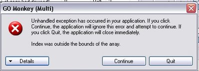

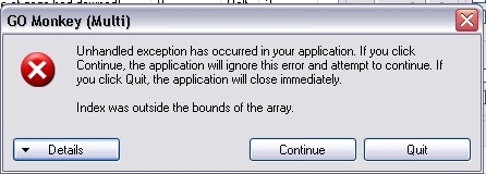

lhunter17
Re: GO Monkey - Theater Cue Stack
I have just added some new cues to a working xml file and i got this error message, does anyone know what it means, what has caused it and how i can sort it. also 2 of the cues that i added don't work.
when i remove the two cues that aren't playing, i dont get the error. The two cues are just colour and gobo changes
