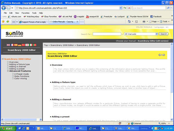

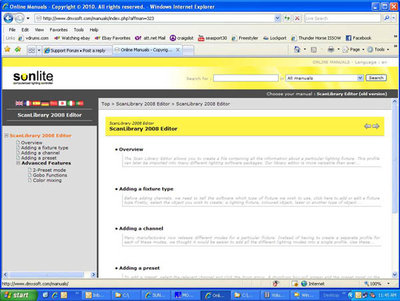

This link http://www.dmxsoft.com/manuals/index.php?affman=323 takes me straight there. Not sure why it doesn't work for you. It should take you here:
The pdf manual you posted is not the same manual for the new Scan Library Editor. The attached pdf is for esa, but has nothing about the new scan library editor. I
