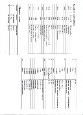

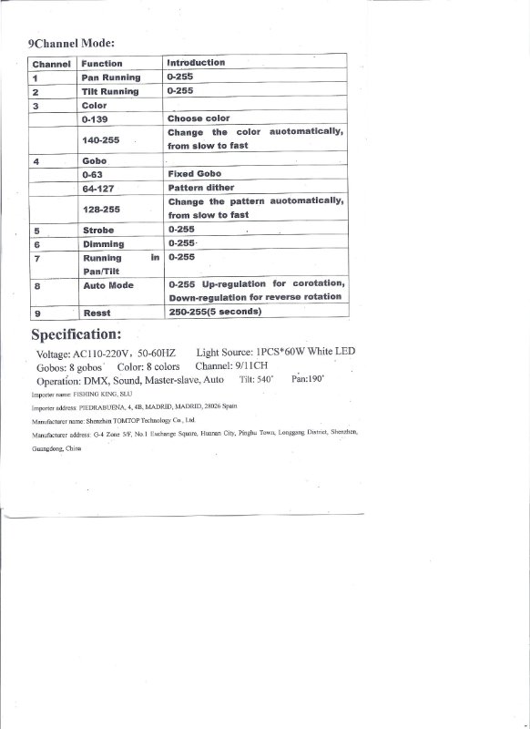

looking for a profile for tomtop/lixada 60w mini led spot.
when i purchased these lights they were advertised as lixada....
when i recieved them, the lixada name was nowhere to be found.
on the box it says manufacturer is Shenzhen/TOMTOP.
the only manual that came with them was a piece of paper with some dmx info.
any help would be appreciated.

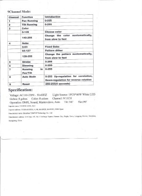

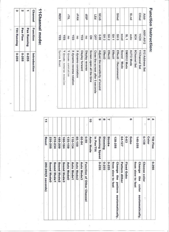

Downloaded file..
Can't be the right one...
mine has 14 colors, 8 mono 6 split not 11
Mine also only has 8 gobos not 11

I got it all figured out EXCEPT the macros.....everything else is working.
