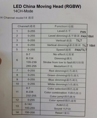

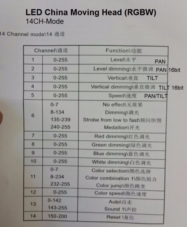

Re: Fixture for Lixada Moving Head
Hello
i also need this Fixture.
Atteched you will find a list of the channels.
- Posts: 905
- Joined: 16 Nov 2016, 14:24
- FreeStyler Version: 4.1.7
Attached is a first attempt
If you can supply more information:
- channel 6, what does DMX values 240-255 actually do
- channel 11, details as to DMX values 8-255
- channel 13, details about Auto and Sound
macros and/or custom sliders could be defined that may make using the fixture easier.

APC40DUB
Yes Rod, it work great for me!! I DJ reggae club. Thanks Peace!! APC40 DUB
Thanks for this, works fine for 4 Lixada's I bought recently
Just have to figure out why blackout doesn't work.
Edit: just had to edit the fixture and define channel 6 as shutter, now works perfectly fine.
