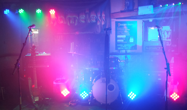

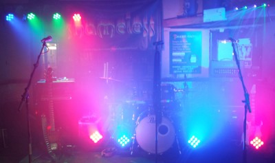

Here is a photo of the lights at a recent gig we did. The Rasha lights are on the floor. The center lights on the tree are the ADJ Tri7's, and the outer 2 are Tornado F5's, which are an e-bay knock off of the Blizzard Fab 5.
