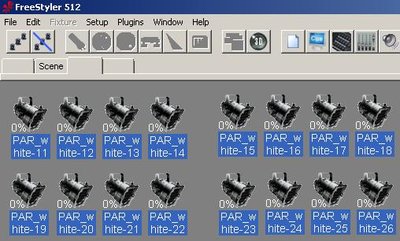

lemysys wrote: I have 2 x Elation Pro bar 4 how can I use these in the freestyler?
I have four of these myself if you are thinking of this one (just with IEC output for each Channel in stead of Two three prong Edison sockets per channel):

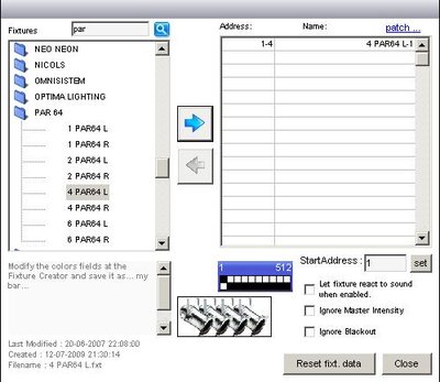

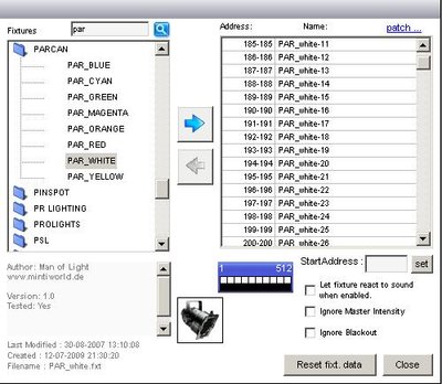

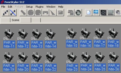

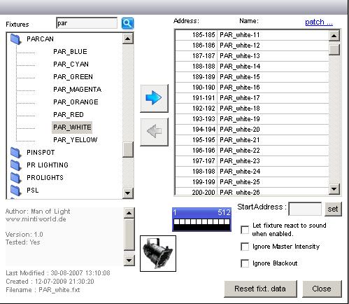

There is several ways you can control them in FS. What i do is to patch each DMX channel from the bars to par cans fixture in Freestyler:

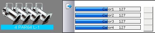

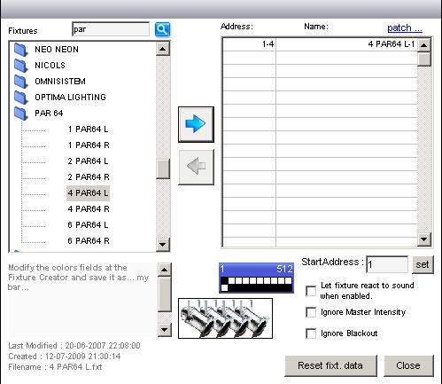

Freestyler also have a fixture for 4 par cans you can use instead:
(Remark: The pictures of "Add/Remove fixture" windows differ from Freestyler 3.0.1 because I have a beta version, but works the same)
I like to patch each dmx channel to a fixture in freestyler because you then can use the FX generator and i can control each selected DMX channel from my MIDI controller.
Hope that gives you a clue how to control the Pro Bars. Otherwise ask again.

Hi LJ,
Thank you for your help it works. :D
