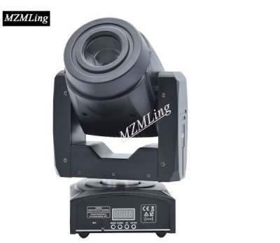

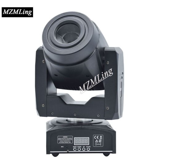

I have buy Freestyler 3
with driver,, all fonctionnal...
so the problem i can't find the library Fixture
for Moving Head LED 60 Watt With 3-Prism
https://www.aliexpress.com/item/3264791 ... 3e5fLPvLHO
1 Brand Name: MZMLing
2 Item Type: Stage Lighting Effect
3 Voltage: 90-240V
4 Occasion: Professional Stage & DJ
5 Style: DMX Stage Light
6 Model Number: NO.037
7 Power: 90W
8 Power Input: 90-240V,50/60Hz
9 Power consumption: 90W
10 LED Source: 60W White LED
11 DMX channel: 4/15 channels
12 Color wheel: 7 colors+white, rainbow
13 Gobo wheel: 5 gobos+open, shaking
14 Control mode: DMX512 /Sound/Auto/Master/Slave
15 Prisim: 3-facet prism
16 Focus: Motorized
17 X: 540 degrees
18 Y: 210 degree
19 Beam angle: 13

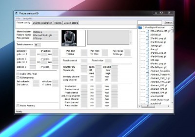

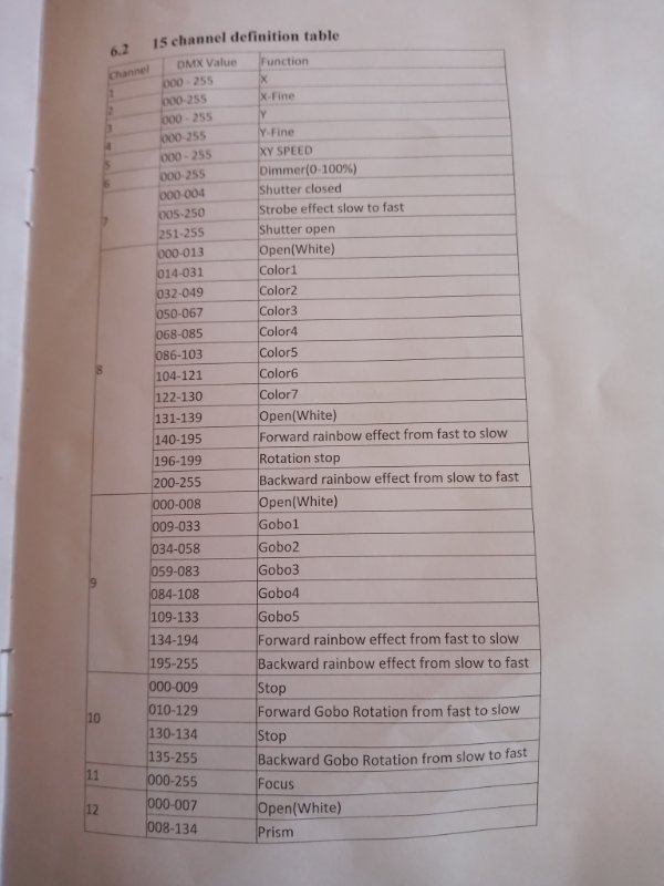

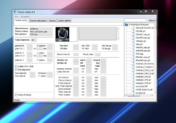

i try created the fixture for this moving head,,,,,
so i am newbie and i am blind,,, and i got 12 moving head,,,
i got fixture creator,,, the moving head got 005-015 channel

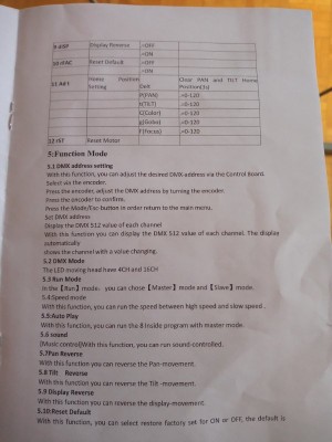

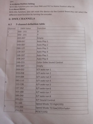

Re: NEED HELP

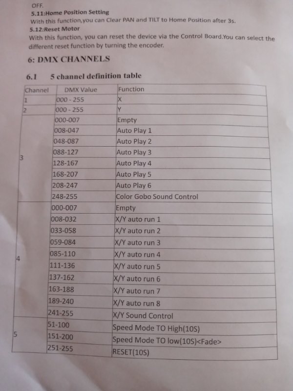

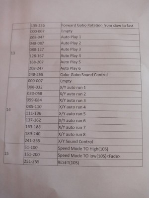

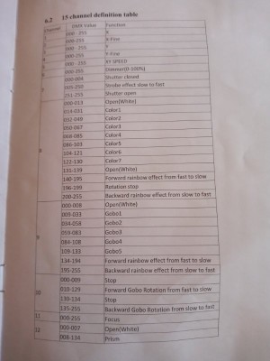

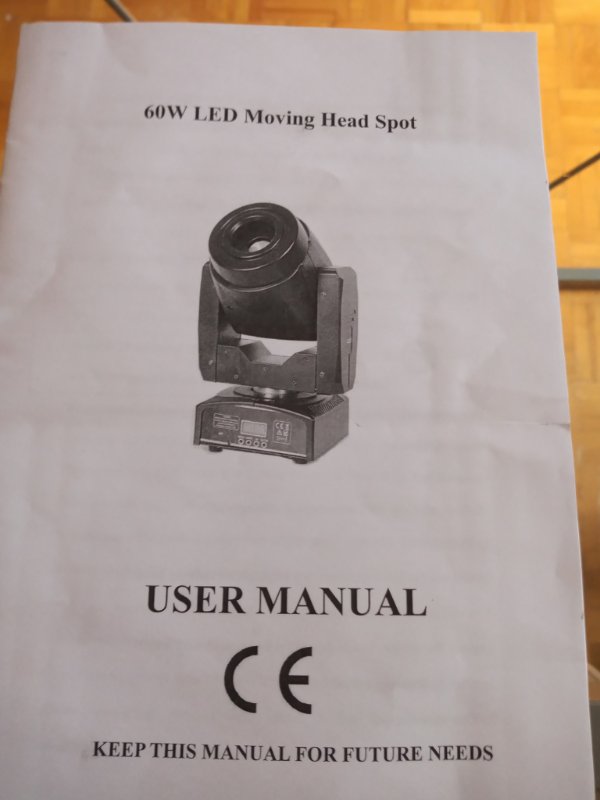

user manual
page 1-2-3-4-5-6
page 1-2-3-4-5-6

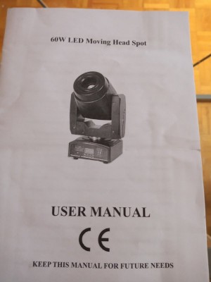

Moving Head 60W 3-Prism

Re: NEED HELP
fixture creation can be a lot of work, there is a link on the forum to purchase someones time to produce a new fixture for you.
To do this your self use the fixture in 15 channel mode
PAN 8 bit = 1
tilt 8 bit = 2
intensity = 6
shutter = 7 closed 0, open 255
strobe = 7, off 0 slow 50 med 128 fast 250
1st colour = 8 no colours = 8
gobo = 8 no gobos = 6
you will need to play with the strobe values, and gobo and colour values and channel descriptions.
there is a good tutorial in the wiki how to use the fixture creator.
PAN 8 bit = 1
tilt 8 bit = 2
intensity = 6
- Just started using FS
- Posts: 10
- Joined: September 5th, 2020, 8:18 am
- FreeStyler Version: 3
Re: NEED HELP
thanks you Mattotone
i have finish this creator fixture,,, now all working,,,
