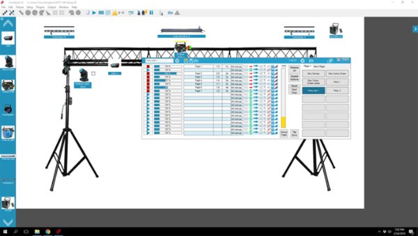

Ok I'm stumped on this one. Been loving freestyer as a Dj it has been great and has most of the options I need more so then alot of big name softwares.. But this one has me stumped so hoping you can help. As a dj I need sound control and single button loads. Im using a Apc Mini for midi control. Now the problem I have seems simple. I have build Sequences is some 15 to 20 steps that I load into the cue list and assign them to a Cuelist button. But when I hit play it loads every single sequence in the cue at once. Is there a way to start with say the first in the list and have it look though them all and repeat. Thanks for great software and great help.

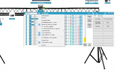

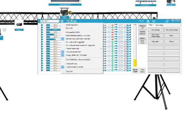

Try this:
In the Cue Window click on the gear icon in the left hand side of the menu bar
Make sure Loop All Sequences and Always start with 1st Scene are checked.

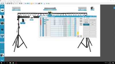

I have that set but when I hit the cue button it still loads every sequence at once. until they all run.. then they will run as they should. the result is a few seconds of crazy light show. I am running the latest verison of freestyler could be a bug. must most liikly something I have wrong someplace

Something else to try. In the Cue window click on the gear icon on the RIGHT hand side. Click on Load Cue Only.

Post by Partyman »
In the cue window top left is gear icon, make sure that "Cue Multiselect is always enabled" is NOT checked
