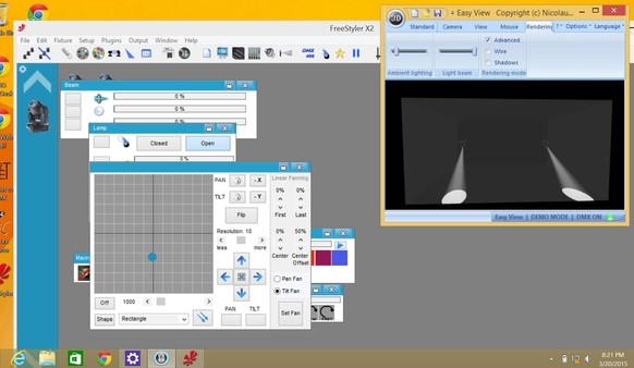

WINDOWS 8:
I have installed this onto a Windows 8 64 Bit OS Laptop.
Freestyler Works Fine.
My findings below:
*The SLMEV icon in Freestyler DMX X2 (FSDMXX2)will not launch the SLMEV Application.
*You can Run the SLMEV application for the Start Menu Magic.exe
*You can no longer select Freestyler as an Interface if you run SLMEV directly from the magic.exe. You can only select ArtNet or SandNet.
*If you run Art-Net you can install the Microsoft Loop Back protocol to run SLMEV controlled by FSDMXX2 on the same computer. As shown in Image. (Tutorial to Follow)
*You no longer need to copy the MEVP.zip to run the current version of SLMEV with FSDMXX2
As previously mentioned I will put together a simple tutorial to assist users with this.
I will also test this more aggressively over the next few days and post my findings here.
My findings below:
