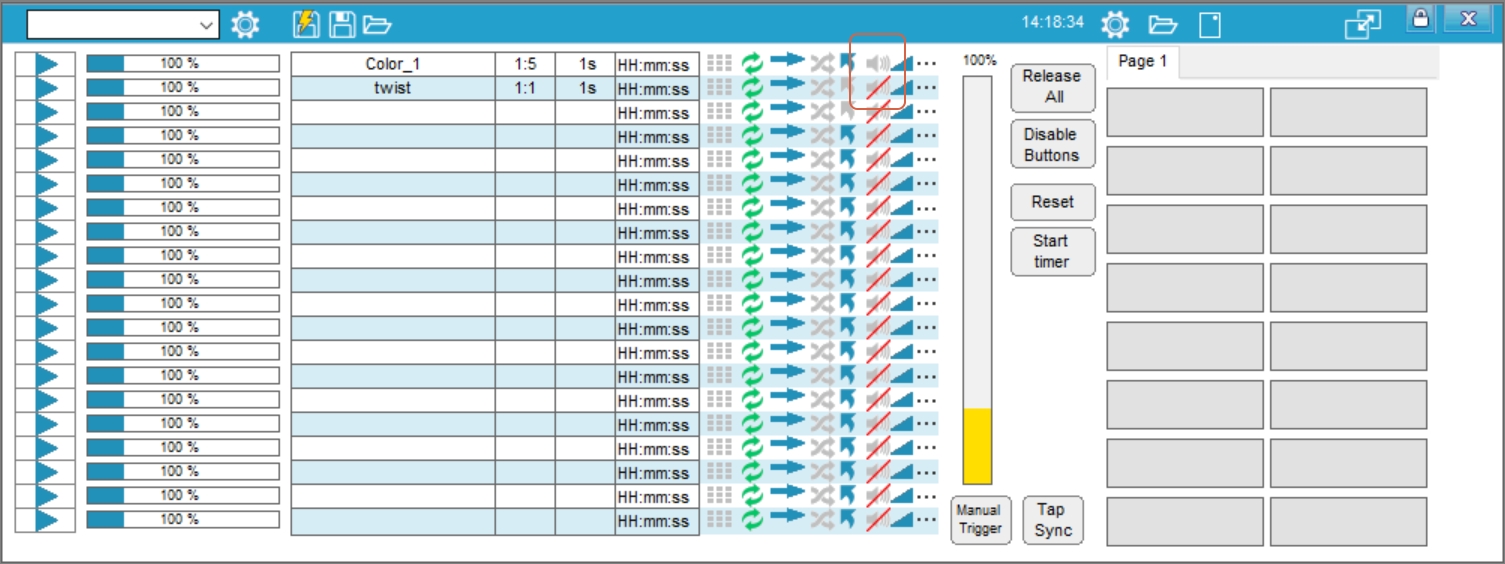

Sound2Light configure the cue window.
In this example we have two sequences.
Color_1 which is a sequence with 5 scenes / steps and sound control is enabled seen by the speaker symbol in the option part of the line.
The other sequence is twist which is a movement sequence created with the Bezier shape tool. The Bezier shape movement is can not be sound controlled and therefor are the sound option disabled.
