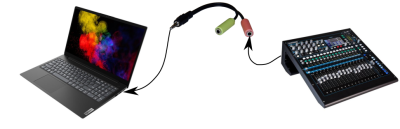

Audio signal considerations.
Some PC’s has a line input direct and other only has a headset input where you need use a speaker – microphone splitter to access the line input.
Note also that microphone input may have a 5V DC which means that your line signal to the PC must be AC coupled.
(I have not been able to find a inline box which makes a DC isolation, DC filtering but they are available)
