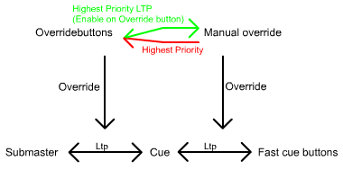

Diagram
Layer1(Override): Between Manual override and override buttons you work with LTP = Letest takes Precedence and it have Highest Priority.
Layer2(Playback): Between submaster, cue and fastcue buttons you also have LTP
Layer1(Override) Will allways win from Layer2(Playback).\\'
so if you make a Manual override or use a override button it will override the Submaster, cue, fast cue buttons or Default Fixture value.
