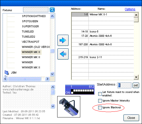

It may be necessary to have fixtures that are ignored when the “blackout” button is pressed.
For example: A DJ wants a light on himself at all times with one of his fixtures - “fixture A”.
The “fixture A” light intensity is to be adjusted once and the colour is to change with the rest of the setup.
“Fixture A” shutter is to be controlled seperately - making it possible to have a light on the dj when the rest of the lights are turned off with the “Blackout” button.
To do this the fixture can be set to ignore blackout .
This is done in “Add/Remove fixtures” - which can be found under the menu “Setup” → “Add/Remove fixtures”
