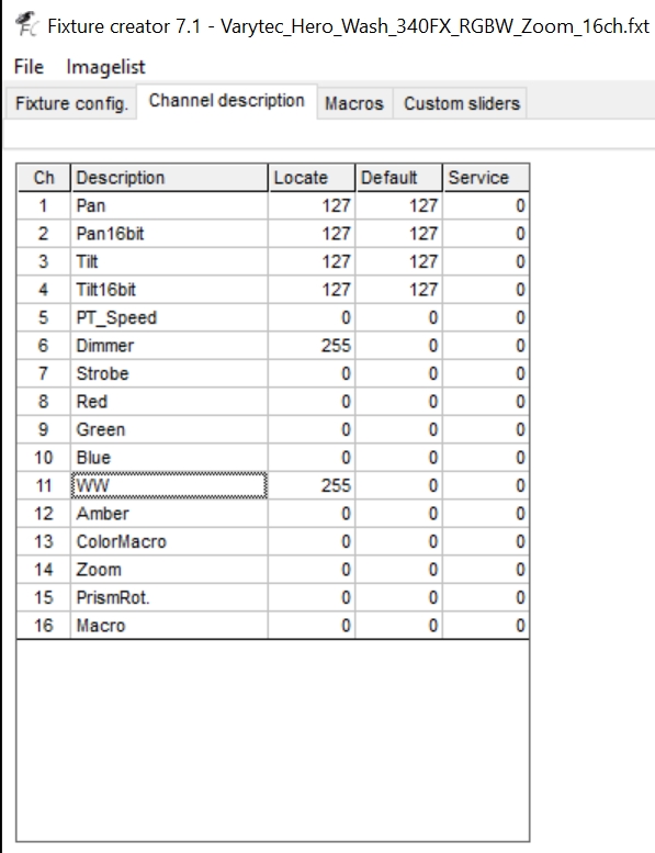

NOTE:
If the channel labels given by Fixture Creator is improper / not telling then please edit them.

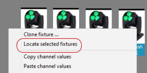

Locate:
Locate is a functionality to find the fixture on a complex gig.
By right clicking on the selected fixtures the popup menu has a menu point to locate fixtures and by clicking point the values in the Locate column will be send to the selected fixtures and that way you will be able to identify the fixture.
As this is to find a fixture the Locate column normally contain values which turn light on like Dimmer = 255 and eventually a color if it is LED.
Default Value:
The values in this column are the default values which the fixture is set to during start up.
These values can individual be overwritten with the startup values which are set under “Edit” → “Save as startup values”.
When you create a fixture it is important to think about what state the fixture shall be in when FreeStyler is started.
Example: A movinghead pan and tilt set to 127 will position it in a center position.
Turn lamp on will not be a god idea for other than you so that is a no go.
In general most values are best set to “0”
Service: This column is intended to facilitate maintenance, like swapping a lamp, cleaning a lens…..
It can at the moment be applied from midi and touchscreen.
Note that the fixture above don't have any maintenance functionality so therefore these values are set to 0
