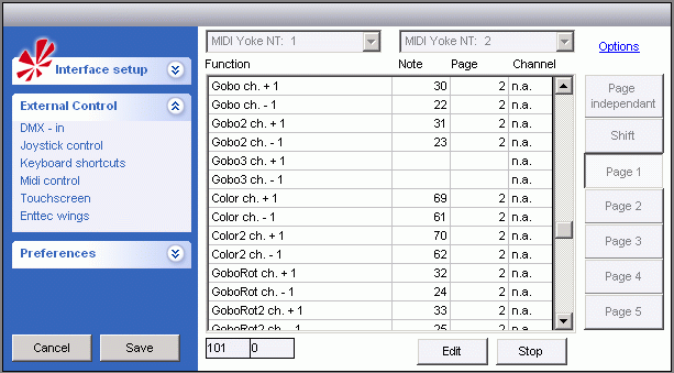

  10. Select eventually Page mapping. Here all functions are mapped to Page 2
  11. Continue assigning MIDI functions to buttons or knobs as you wish.
  12. Once finished, click “SAVE”.
Page
The Page mapping is used to give a note (control) multiple functions.
“Page independent” means that the function mapped to this note will always be the same no matter what the page settings are. It could be functions like “Master intensity” and “Toggle blackout” which is functions that are nice to have available no matter what page is selected.
In all the other page settings the note and the mapped function is only available on the selected page. Example could be a button that has note 10 with page 1 selected it is “Open Gobo” with page 2 it is “Open Color”, with page 3 selected it is “Open Pan/Tilt and so on.

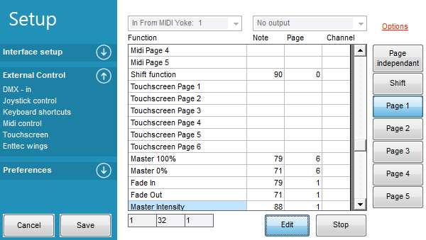

Shift Function
You can configure FreeStyler to use one button on a controller as a shift button, so that when it is held down and another button is pressed, you can respond as if it were a different button. E.g. you might have a button on your controller that runs submaster 1, but when you hold the shift button and press it, it toggles blackout for group 1.
Any button on the controller can be configured as the shift function (in this screenshot it's button with MIDI note 90).
Then in order to program FreeStyler to respond to shift + button, you set the page to 6 (see screenshot).
You have to click the “Shift” button on the right side of the assignments and then only press your button on the controller normally (don't press the button programmed as shift or it will get reassigned).
Then when you're finished, change the button in FreeStyler back to Page 1.
Note monitor
In the bottom of the window are a small monitor of the input notes.
In the screenshots above, the first shows note 101 with a velocity 0 and the second shows note 1, velocity 32.
Here it is a fader that is monitored but if it is a button then the velocity value is to be 127 for FreeStyler to recognized the button press. This can be alternated on most midi devices.
