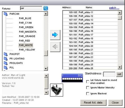

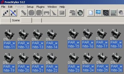

There is several ways you can control them in FS. What i do is to patch each DMX channel from the bars to par cans fixture in Freestyler:
16 fixtures to control 4 Elation Pro Bars
Each Fixture is patched to one DMX channel on the Pro Bar

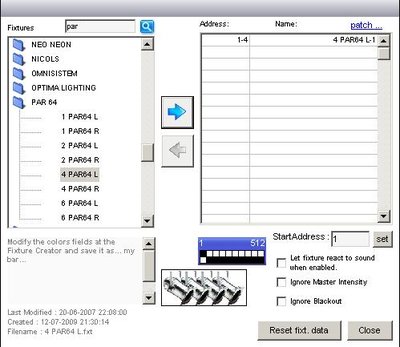

Freestyler also have a fixture for 4 par cans you can use instead:
A fixture which contains four (dimmer) channels, one for each Dimmer on the Pro Bar
Each Fixture is patched to four DMX channels for one Pro Bar
