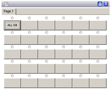

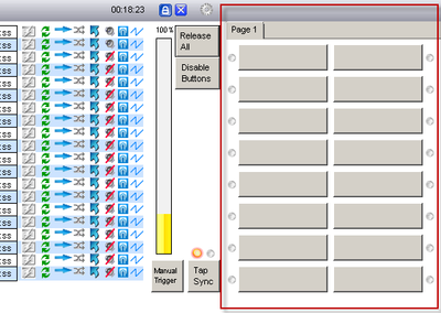

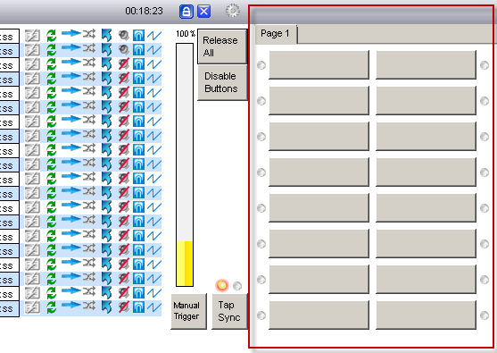

@ yofo. I really think you should read the help file in Freestyler.
as far as i can see in your screenshots you haven't set up a override button. that's why you get the error.
I know you are confused now, but again. read the help file, but I will give you a hint:
this is not override buttons but cuelist buttons which is a completely other thing. read the help file for more information.
press the override button icon in the tool bar to get the override button window

Re: Strobe to sound
You are missing the point.
Beat flash does NOT control the cue window or the bottons on that.
Beat flash only controls override buttons, which is another window. So open the override buttons window and try with that. Also re-read my previous posts, might help you in the right direction. Read the help file. Keep in mind that override buttons does not play a complete sequence, but just the first step.
The cue window just gets the regular beat detections from S2L (and if enabled the multiplies). Beat flash functionality is for another window.

yofo
Re: Strobe to sound
Now it works,LJ_krede.dk wrote:@ yofo. I really think you should read the help file in Freestyler.
EDIT: Now my laser acts as a sound to light strobe, every beat makes the laser go on for that 100 milliseconds or something... and then I just move some other slider to make it spin around, so it looks insane now, thx u all, now I also know what a override button is....
