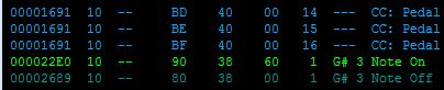

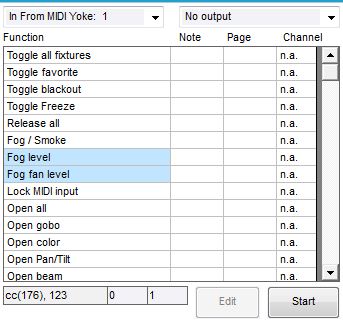

Well I thought I worked it out. It worked just one time. Can you please make a tutorial? It is still not working.
I made screenshots of my settings.
Do I need to open Freestylerdmx also when I use Go Monkey?
How can I capture the midi cc? It goes very fast and it returns everytime back to 248. I already tried different settings with the midi device (cc notes on/off etc. see screenshot).
In which state must Freestylerdmx be?Must I define the midi device I want to use in Go Monkey?
Do I need to have the midi device to be started in Freestylerdmx?
When I have defined the midi settings in Go Monkey. In which state do I have to set Go Monkey to let Go Monkey do the work and listing to the midi? Do I need to start Midi?
Is there also an order for all those programs to start up so it will propperly?
Reaper, Freestylerdmx, Go Monkey for example?
I am using Midi Yoke 1, is this a good way to work or I need to work with other midi in and outputs?
- go-monkey.JPG (11.82 KiB) Viewed 28166 times

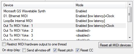

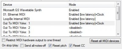

Then, you'll need to make sure your MIDI outputs are Enabled. Make sure LoopBe1 is running (should be visible in your Taskbar) and then
In Reaper:
1. Go to Options --> Preferences
2. Click on Audio --> MIDI Devices
3. Underneath where it says "MIDI Outputs to make available", make sure LoopBe1 is Enabled. If it says <disabled> then right-click on it and Enable it so it looks like this:
Inline image 1
4. Finally, go to your MIDI track in Reaper and click on the little button next to the track title that says "I/O"
5. The Routing window pops up. Where it says "MIDI Hardware Output", use the dropdown to select "LoopBe Internal MIDI"
So in reaper you should have already created a midi track and created any note.
2. Make a loop region on around your midi note ( so when you push play and leave the program it keeps looping the midi note.
3. Now push the play button in reaper and make sure it keeps looping so it plays so gomonkey can detect the midi trigger.
4. Now go to gomonkey and go to setup and click in the midi field where you want reaper to send midi trigger.
Gomonkey should automatically recognize the midi trigger from reaper.
Then, all you should have to do is hit Play on Reaper. The MIDI will get sent through the LoopBe1 output, and FreeStyler should receive the MIDI triggers which will activate your sequences.
Good luck... I hope it works for you! It's pretty sweet to see the lights triggering in time with the music.
Inline image 1

Hi,
I'm trying to get Multiplay to work with GO Monkey, and looking back through this thread it looks like others have managed it. The Multiplay cue is set to send 127 and then 0 as a CC.
I'm using LoopBE1 and Multiplay looks like it's outputting MIDI correctly (viewed via MIDI-OX), but I can't get Go Monkey to respond. GO Monkey allows me to select from 3 midi devices ( device 0, 1 and 2). I'm not sure which, if any, of these is the LoopBE1 input?
Any ideas??
Thanks
Richard
Any ideas??
Thanks
Richard
dickykitch
- Posts: 2
- Joined: 26 Jan 2015, 23:00
Re: GO Monkey - Theater / Band Cue Stack
Of course, no sooner had I posted the above when I made some progress
. It seems the LoopBE1 input was not Device 0, 1 or 2. I removed another physical midi device (V-Studio 20), and now I can get GO Monkey working on device 1. It will also work with a Kord NanoPAD as device 0.
Does GO Monkey only work with midi inputs if they are in the first 3 device IDs?
Thanks
Richard
Thanks
Richard
