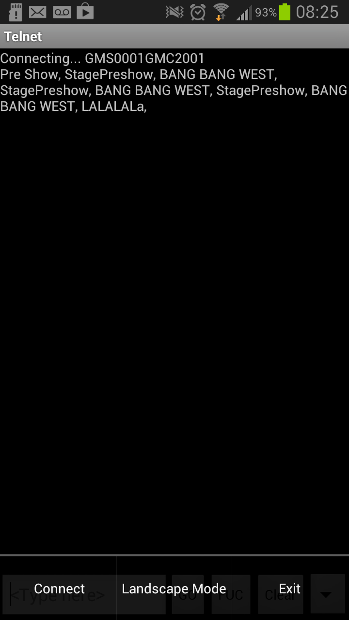

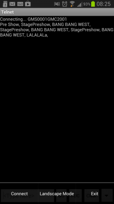

Re: GO Monkey - Theater Cue Stack
Tcp/ip access to Gomonkey ready for iphone and android apps.
Using standard ASCII format.
GMS <- Commands from the server.
GMS0xxx Server version, sent upon connection I.e GMS001 version 1
GMS2001,xxxx,xxxx,xxxx,...,xxxx List Cues in Cue Stack
GMS2002,xxx Current Index in Cue Stack
GMC -> Are commands from the client
GMC0000 Disconnect
GMC1001 GO
GMC1002 BACK
GMC1003 STOP
GMC1004 BLACKOUT
GMC1005 FAVORITE
GMC2001 Send Current Cue Stack as CSV
GMC2002 Send Current Index in Cue Stack

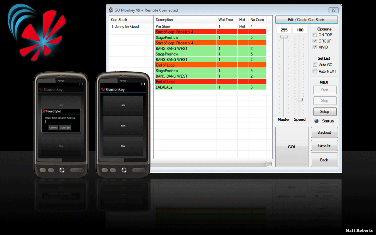

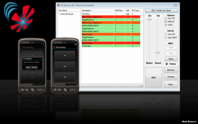

Version 9
TCP/IP Server with Android App.
