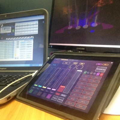

Hi Everyone,
Below are the details on setting up and configuring TouchOSC Interface for controlling Freestyler DMX.
Instructions maybe a little rusty however let me know your feedback. Also I will do a tutorial video soon.
What you need to download the configuration files from the link below.
Install Instructions
http://www.freestylersupport.com/commun ... ctions.txt
Layout Files
http://www.freestylersupport.com/commun ... d.touchosc
http://www.freestylersupport.com/commun ... e.touchosc
Midi Control Map
http://www.freestylersupport.com/commun ... ver356.fms
(Right Click and 'Save Link As')
Download the software for configuring the APP below:
Windows 64 Bit
http://www.freestylersupport.com/commun ... -win64.zip
http://www.freestylersupport.com/commun ... -win32.zip
OSX
http://www.freestylersupport.com/commun ... .0-osx.zip
Or download the original software install files from the link below.
http://hexler.net/touchosc
If you need more information regarding the TouchOSC software or troubleshooting go to the link below:
http://hexler.net/docs/touchosc
Don't forget you will need to download and install the APP from the iTunes Store for iPad or iPhone.
Thanks
Buttza.

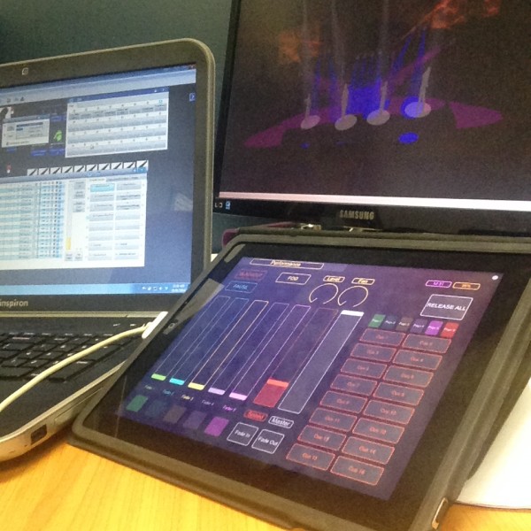

A bit further along.
Here's a vid.
http://youtu.be/r6usBb8phA8
Once I have finished this I will do an iPhone Version as well.

Ok here is an update.
So I have just finished my first version of TouchOSC for Freestyler DMX for iPhone and iPad.
I need another person to test it.
If you wanna try it PM your email.
I will start my tutorial next week and hopefully have it ready for general use Friday next week.

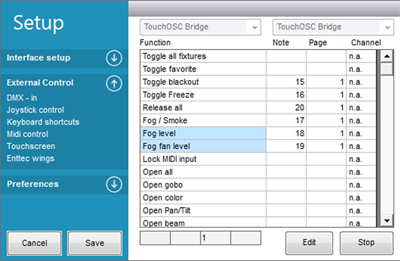

short version .. probably just as well .. managed to get iPad up and running by reverting to iMac for setup, looks great BTW .. but can't get FS to see TouchOSCbridge?
I get a Roland midi driver in the FS output menu, which is in the PC's sound, gaming controllers folder as well as drivers for a Nerd's LoopBe1 virtual midi driver I installed (& didn't help
, but the Bome's midi driver, I assumed needed for TouchOSCbridge? is unrecognised in the system devices folder ..
I also looked at another thread viewtopic.php?f=38&t=5193&start=10&hilit=touchosc+midi .. on midi control but, still no luck ..
I've reinstalled & restarted to no avail and open to any suggestions ..
Thanks again and cheers,
John E Mac

Hi,
Make sure that TouchOSC is running in the background before you open FS. Also restart computer after the TouchOSC Bridge Install.
You will need to Open Freestyler then go into Freestyler setup. Under external control select midi. At the top of the list there should be Input output options.
Also check firewall settings too.
Are you running the latest version of Freestyler?
Thanks.
Robert.

I have just realised that the Midi.fms file I included will no longer work with the FSDMX 3.5.6 so I am in the process of updating it. I will push the update through by Friday. Thanks.

I have Updated the midi mapping file to work on the current FS 3.5.6.
The file is located on the first post of this thread or linked below. Sorry for the delay.
If you have any issues please post here. Thanks.
(Right Click, 'Save Link As')

Hey Buttza, thanks for setting this up! Works like a charm - well sort of.
I was pulling my hair out trying to figure out why it wasn't working. I could see in the Midi Setup that the note was being received by Freestyler, but nothing was happening.
I had to go into the Options and select "Ignore Midi Channel" in order to get anything to work... not sure if this will cause issues later, or if I missed some step. Any ideas here?

I think I mapped the Midi channel to use 16 in Touch OSC by default. Try setting the midi channel to 16 in Freestyler Midi Commands.

One other question, and it likely comes down to me not fully understanding the TouchOSC Editor.
I've been tinkering with your layout. I added a Tap Sync button to the Performance Tab so that I can easily sync my sequences to the music. But I was looking at the buttons on the Override Buttons tab, and most of them don't seem to have a Midi Note associated with them. How do they work?

Yeah they should work. I will check the midi to check if they are in there. It may need to be updated for the X2 version.
I haven't updated for that so I will do it this week.
Cheers for the heads up.
I can add a tap sync button to it as well if you want? I forgot about that function.
