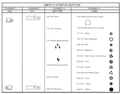

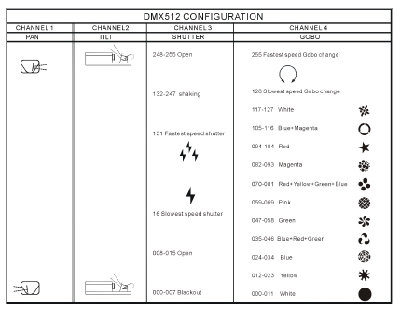

I have just started to use DMX and I am having trouble creating a fixture file for my Acme Dynamos.
I have attached the fixture file that i have so far - but I think it's pretty wrong and incomplete.
If you could help in any way, I would be much appreciated as I am tearing my hair out and I have a gig tomorrow!

hey
I opend the file but no channels are set? only the number of total channels are set.
as fa as i can see at the poor picture, it is a pretty simple fixture to make.
as you can see pan is written under channel 1 and tilt under channel 2. when nothing else is specified ("8 bit pan" and "16 bit pan " for example, same thing for tilt) for the fixture, it is only using 8 bit for pan and tilt. therefore you write 1 at 8 bit pan and 2 at 8 bit tilt in the fixture creator. It is that simple
for channel 3 it is specified it is the shutter channel, so you write 3 for the shutter in the creator. now you can specify the dmx value for open and closed/blackout. for the strobe effect i will recomend you to write 3 for the shutter, and write the values for slow and fast.. you can calculate the medium value ( (131-16)/2+16= 73,5--> 74 )
for the shake values i would use the macro feature
for the goboch 1 you write channel 4 and 14 for n gobos. at last, you go to the gobowheel fan and write the dmx vlues for the gobos. again i recomend you that the first three you set to 255, 192 and 128 for fast med and slow rotation of the gobo wheel. you can find a proper picture for each gobo at the right.
i hope this wil give you insight of how you make your own fixture... give it a go and write again if you have problems.

you set both the shutter and stobe channel to 3 in the fixture creator, not only the shutter as i wroteLJ_krede.dk wrote:for the strobe effect i will recomend you to write 3 for the shutter, and write the values for slow and fast.. you can calculate the medium value ( (131-16)/2+16= 73,5--> 74 )
for channel 3 it is specified it is the shutter channel, so you write 3 for the shutter in the creator. now you can specify the dmx value for open and closed/blackout. for the strobe effect i will recomend you also to write 3 for the strobe, and write the values for slow and fast.. you can calculate the medium value ( (131-16)/2+16= 73,5--> 74 ). now you control the channel 3 both with the shutter and strobe function. I would thing it is the same behavior in almost all fixtures
