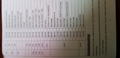

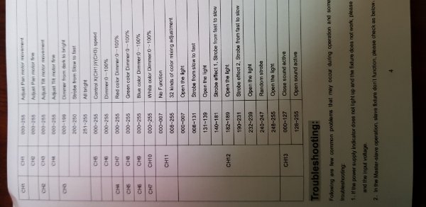

I have managed to tweak this to start working correctly like tilt and pan, but can figure about strobe and shutter and I don't know what to do with sound activation but the basics moving and changing light is there as I'm new to this. many thanks

plus I would like to know how to fade it in and out and it automatically defaults on load the colour red, I cant see a clash in the settings

The basic STROBE (OFF, slow to fast) can be specified in the Strobe setting in the primary fixture creator window [Strobe ch.]. For the remaining strobe functions I've used a combination of Custom Sliders and Macros. Give it a try.
Please use the Fixture Creator Export Function (File -> Export) to create the attachment. The .FXT file contains pointers to other files and thus is not complete in and of itself. The Export function includes all of the referenced files.
