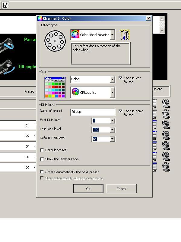

I have been doing some testing with a high end trackspot in the Easy 3d visualizer and have run into a problem. I went into freestyler and had to make some adjustments to the dmx values because I had problems making it work correctly with the visualizer. That has fixed the problem, except that when I try to do a color or gobo wheel rotation it will not work, and this is the only thing that doesn't work, and I can't figure out why. I have checked and rechecked the dmx values in Freestyler as well as the Trackspot V2 device in Scaneditor and everything is correct.
On channel 3 for the color preset drop down menu, there is a preset that is made especially for the color wheel rotation. It's set for DMX values 1 to 127 and an RLoop Icon. I added a screen shot so that you can see how I've set it up. Can someone take a look at this and tell me if I've done something wrong?
Thanks,
Ryan

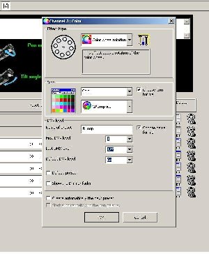

Ok that wasn't it but I did figure out what it was. On the effect type setup, at the bottom it lists the min and max dmx values. I had the wrong values set. Apparently you are suppoesed to exclude the actual dmx value of the effect you are wanting. This did the trick. Thanks so much for your reply.
