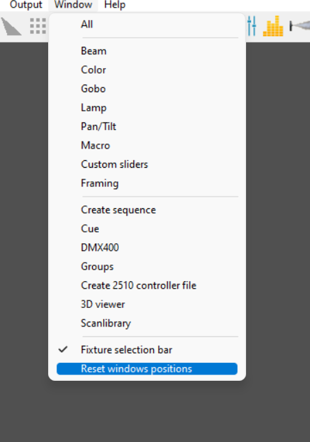

Click reset window positions, let me know how you got on..

Re: Lamp Settings not showing up.
Hi.
So I solved the problem.
All you had to do was connect an external monitor and assign it a left screen.
The window appeared there, so I just moved it to the main screen.
BUT on another laptop, this helped me without connecting an external monitor
Thanks a lot.
Thanks a lot.
- djSupport
- Posts: 1915
- Joined: 09 Jul 2007, 18:57
yes, so that button would of worked if you hadnt had an external monitor so its a good feature to know
