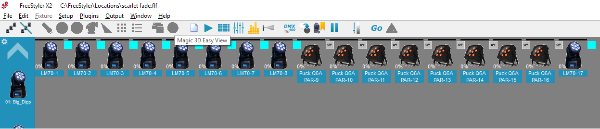

i am running the latest version of both FreeStyler x2 and 3D Easy View, but for some reason 3d easy view DOSE not work with my freestyler, i have a show coming up on Saturday and im trying to get it all programmed, but i am not able to use the 3d easy view, any tips on how to get freestyler to recognize 3d easy view?
i have not even added in all my lights yet, because i need to figure this out first

ok apparently my picture is crap lemme fix that
JartzVoiceMan
Re: 3D Easy View
Post by JartzVoiceMan »
http://imgur.com/gallery/KQ8fw
this is a better res pic

Did you select to install easy view while installing freestyler? If not reinstall and click the checkbox

As party man mentioned above.
Failing that you could use the loopback adapter option.
viewtopic.php?f=6&t=6406&p=26408#p26408

hi JartzVoiceMan ,
I have figured it out the same problem like you , pls uninstall your 3D easy View software and install it in same freestyler folder example below
C:\FreeStyler
in default freestyler installer will install in C:\FreeStyler, so pls install your 3D easy view in same folder as well .
after it, u will see that 3D easy view Black button will appear in freestyler software .
