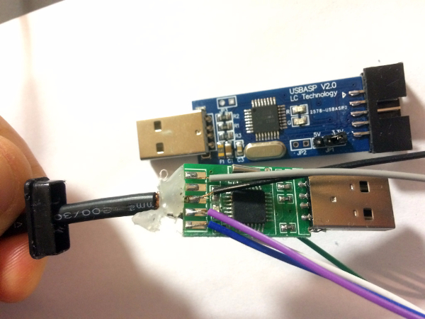

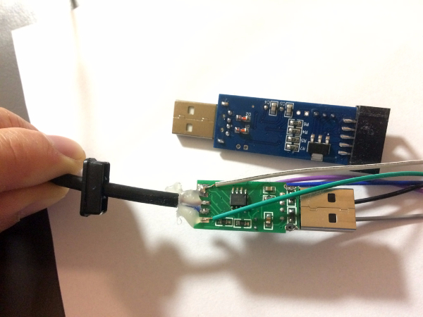

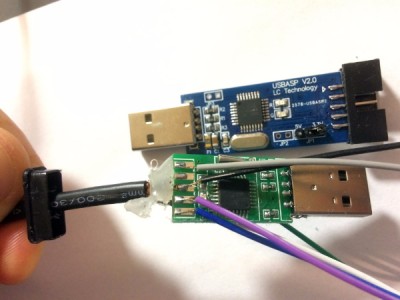

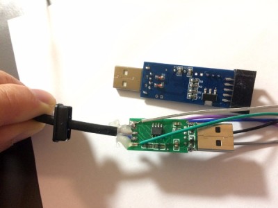

pisach
Re: FreeStyler X2 and uDMX - Setting up second universe
Hello,
I have two different types of these "DMX512 USB cables", one is FTDI based, one is with Atmel's Atmega8.
Now I'm playing with the second. I want to replace the Chinese firmware with the firmware from illutzmination.de. I have AVR USB programmer, I can download the code, read "fuses" etc. so I guess it's connected correctly, moreover I don't do this for 1st time.
When I upload the new firmware nothing happens, it seems it has some protection. Any idea how we can "hack" it?
Thanks!

Hi,
Here is what we have:
This doesn't look as original code. Actually the problem is in the PID/VID, the illutzmination software expects vid=0x16C0 pid=0x05DC, not 0x03eb/0x8888.
As I know the PID/VID is in the code, not in the software, but this is beyond my knowledge
Thanks
I use uDMX drivers, it sold as uDMX, so it should be uDMX...or at least the seller offers it as uDMX.
In other words, I have USB dongle with Atmega8, how to install FW from illutzmination/ANYMA on it?
gferrero
If microcontroller is not write protected, you can burn the new code over your current Atmega8. If you can not write on existent Atmega8, you can use a new blank Atmega8, upload the Illutzmination on it and finally replace the cheap on the board.
Important: you must be sure that your dongle is fully compatible with the anyma hardware.
pisach
it's a $15 controller, it's not worth to replace the chip. It looks same as Illutzmination, one chip, one oscillator and a few diodes/resistors. I don't think it's write protected, probably I don't do it right, I don't know...
What about the "bootloader"? I don't understand the difference. Does it have the same function as the bootloader of the OS? From where I can download bootloader image?
pisach
You can see that it's the same as the programmer, the only difference is is the MAX485 chip....it is just a USB to RS485 converter. It works with other software without problems, I'm trying to run it on Illutzmination SW, that's all.
gferrero
You can see the Lutz modified hardware from http://www.illutzminator.de/udmx-mod.html?&L=1 and check if it's the same of your dongle. I see your hardware uses a SMD microcontroller; in my case Atmega8 is a Dual In Line package inserted in a chip socket, so it's easy to remove.
Unfortunatelly I can not really give tips about bootloader because I never used that. But you may check at https://www.obdev.at/products/vusb/usbasploader.html
The important information is: "The difference is that USBaspLoader presents itself as USBasp
programmer to the host.". So you don't need a programmer because the bootloader USBaspLoader
simulates a programmer. So the programming software should be able to write to uDMX
directly.
