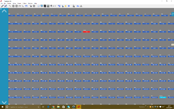

Hello everybody, i have a problem with my Freestyle ScreenResolution, becouse i programme a dancing fountain with more than 300 fixtures, but in the freestyler i can´t see all (you can see in the picture). Please, help me! :(

What fixture file are you using.
And exactly how many fixtures are you using.
ayrtonp
Posts: 3
Joined: 04 Apr 2016, 02:26
FreeStyler Version: 2
Re: I can't see all fixtures
Post by ayrtonp »
Jan_K wrote:What fixture file are you using.
I use my own fixture and they works, i use 387! :D

i'm new in DMX, afortunatelly i can run the fountains with FreeStyler and i can make scenes, but i can't see all fixture :/

I think you need to make a work around.
The fixtures is that a simple 3 channel rgb or is it just a 1 channel dimmer
If RGB then there are the possibility to make a few fixture with the whole fountain light and then use rgb segments for controlling the individual light.
Then you only have a few fixtures on the screen but they each control a serial of rgb fixtures.
If it is only 1ch dimmer then you can make a, for example 10 channels fixture, controlling a group of lights.
It could be 10 light which are located in a natural group in the fountain.
If you only issue is that you can't see the fixtures then you have to raise the issue in the bug tracker.
Eventually make a backup file and add it there so the developer can have a look.
It can take a long time as the developer is normally heavily loaded.
(I think that you shall raise the issue in the bug tracker so that it is recorded)

It is also possible to use Zones in Freestyler.
It gives you 4 tab's to place all 387 fixtures on.
