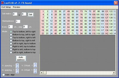

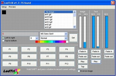

I am not sure if I am doing some thing wrong or if there is a bug
I have a 8 x 8 led bar matrix available
This bellow is not tested in real life. Just on the desktop
As I uses Font 8 I expect that the text will same size as the matrix.
Changing the Font size to 6 don’t reduce the size in the preview window
Also the spacing and offset don’t seems to have any influence is that correct.
Setup window
Setup window
Main Window font size 8
Preview font 8
Preview font 8
Main Window font size 6
Preview font 6
Preview font 6

Yes it seems like a Bug because Size10,11,12, 13 and on seems to work.
only if you go smaller 9,8,7,6 it seems to stay at 9 or 8
try Setmatrix 8x8, V spacing:2, H.spacing:1, enable "Auto. align"
and try "ani3.gif"

I have tried the offset and spacing and there is an effect on gif's but not on the Text.
Also sometimes offset seems to have a life of it's own.
I have tried to set it to some values and then pressing the images.
Returning to the setup page the offset sometimes has changed.
The funny thing is that it is not always changed though I am trying to verify it by following the sequence.
Is there an exact description on the spacing, offset and Auto align.
If not can you then tell me what you know and then I will put it into wiki.
