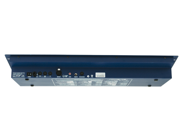

Onge
Re: USBDMX.COM input for external control
Yep it does as you can see on this picture of the connections at the back 3 midi ports, in, out & thru. I will have to blow the cobwebs off it and have a play to see what it can do. Damn I will need to get a MIDI interface on my PC to use it unless I can go through the BCF2000dmxlighting wrote:Does it actually have 'midi out' ?Onge wrote:I have an old 48 channel desk and that has midi as well so I could use that for triggering FS.
Ive got some old desks that allow midi in and midi through but not 'in' Could be very useful if yours does!
