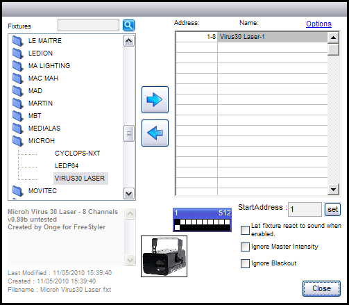

The dipswitches are only for setting the address of where your laser is in the possible 512 channels. They have nothing to do with the values being sent to the laser only what address to send them too.
Start a new show in FreeStyler and add one of these fixtures, you will see the address as 1. See the adding and removing fixtures in FreeStyler tutorial on the FreeStyler wiki for more information.
Now on one of your lasers set dispswitch 1 to on and the rest off. This laser is now at address 1, and so will it be in FreeStyler. Now they can talk with each other.

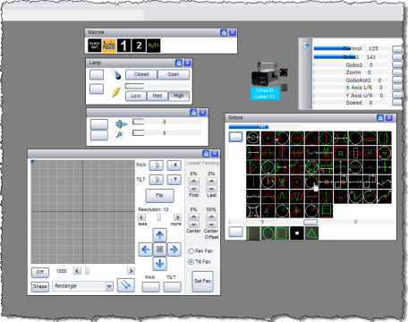

Only have the one laser conencted to your interface and switched on.
In FreeStyler click the patched fixture from the main screen and you will see the sliders to the right side of the screen, hover over them to get them to appear.
Open the windows for this fixture, click the shown icon.
Which will open all these window panels.
I have clicked the 1 in the Macros panel, which then enables channel 2 and then I have selected one of the Gobos from the first gobo wheel.
If you click the 2 in the Macro panel you can then choose an image from gobo wheel 2 and then use all the other controls to control the laser.
Hope that is understandable, you must get to grips with DMX addressing and DMX channels and DMX channel values, without getting this information correct in your head you may as well give up and take up the crayon and paper, I am not being funny.

Your second laser would be at address 9
Your third laser would be at address 17
Patch them in FreeStyler and you will see that it shows the dipswitch settings for these addresses.

ok so heres what i have in the program
and heres the back of my laser
now i think i have everything correct now if i don't please correct me but i'm pretty sure i've got it now >.<
oh and nothing happens when my laser is connected. ive tried all three of them seperately (they all cant not be working grr)

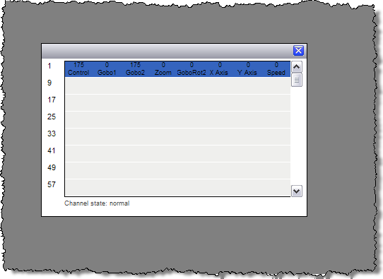

Go to the menu "Edit>Show Output" you should get the following, I also have selected the "2" macro and the "Dot" on the 2nd gobo wheel, so you can see the values being output.
I am also assuming you have got the "Enttec open DMX" selected in the "Setup>FreeStyler Setup" menu, then "Interface setup>Controller".
