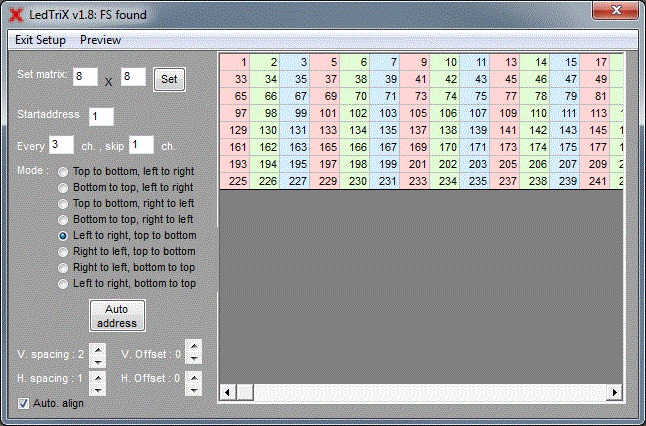

As the first segment in the matrix is upper left corner the mode “Mode” entry is set to this.
Remember to press the “Auto address” button”
Looking on the color / address window the addresses can be checked.
First Kam, segment 1 has adr. 2, 3, 4 and segment 2 has adr. 8, 9 and 10.
This correspond to the drawing above.

** “V. spacing and H. Spacing” **
To demonstrate the spacing function a matrix of 20 x 5 is used.
Spacing is if you only want to mount a reduced no of fixtures.
If this parameters is used then the fixture buildup are to be symmetrical.
The spacing don’t start at the first colon / row but the colon / row with then spacing no.
Also when the spacing is to high so the matrix is larger than the image then the preview don’t perform as expected.
Here spacing 1,2,3 and 4 are shown.
Matrix larger than image.
Here spacing are 5 and 6 and as it can bee seen the function is not well definde here so this setting are to be avoied.
At spacing 5 a black colon appears as expexted but spacing 6 gives an image without spacing.

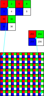

Also a thing to note is that many fixtures comes with a white led. RGBW.
Images only have RGB information and LedTrix has therefore no white control in the setup panel. This means that this has to be skipped like bellow.
The address for each pixel will then look like this.
It is basically a 8 x 8 matrix with all colors next to each others.
Note: The pixel order may be different. Here it is From Left to Right, Top to Bottom but I have not hat a Revo 4 available and have therefore not been able to verify this.
And in LedTrix the Setup where the white channel are skipped will then look like this.
