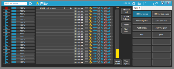

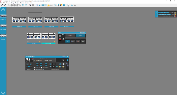

I have a smll problem with my sequences and can't figure out, what the problem is.
Maybe you have some ideas?
I created a cue for an automatic program build in on my Starville CLB5 fixture.
It is a simple colout fade that i want to use in my sequence list.
When creating the scene, i selected the proper DMX values at the right cannels, everything works fine.
See pic 1.
When i use the cue in the sequence, see pic 2, it turns on and after 1 second, it turnes the dimmer down.
See video.
It also dose it here and there with my sequence AS31.
Can any body help here with my problem?
All settings, exept DMX values, are the same in the cues.
thanks
greetings Robin

Your issue may be being caused by one or both of these options shown in the attached pictures (they are ZIPed so you will need to unzip them)
Freestyler_b.zip- (121.05 KiB) Downloaded 137 times
Freestyler_a.zip- (94.49 KiB) Downloaded 166 times

Re: Sequence suddenly turning dimmer off
Hy Rod.
Thanks alot, the setting in the sequence option worked.
Everything stays on now
