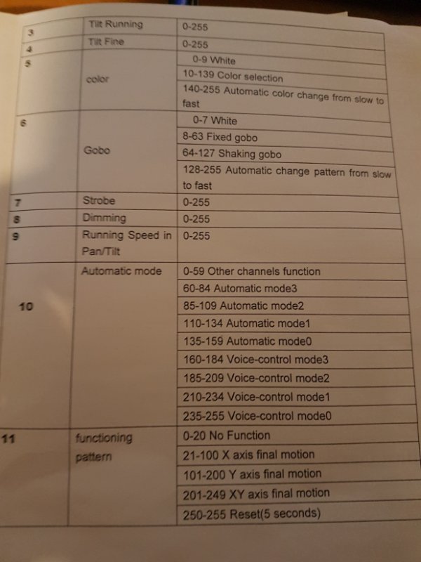

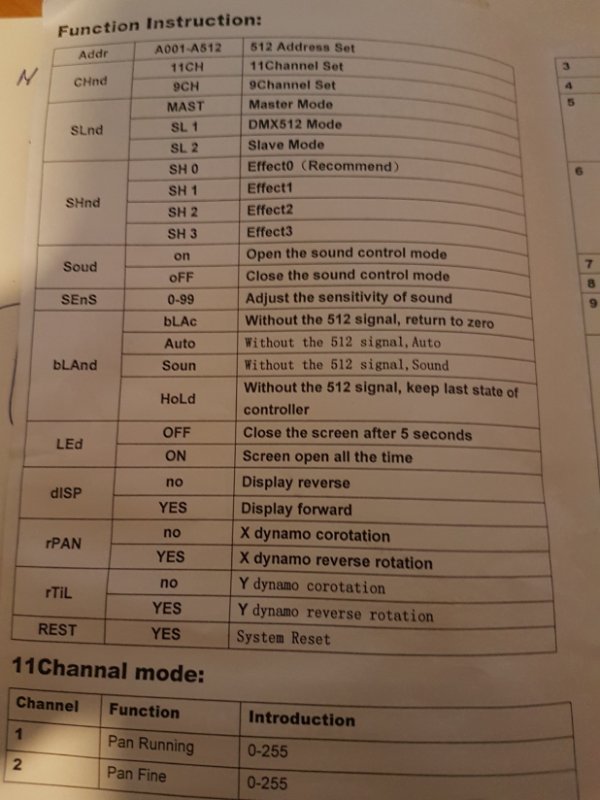

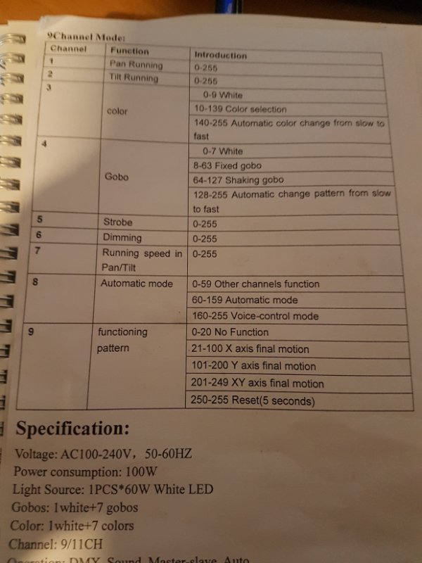

Hello ! I need some help creating a fixture for the Fractal Mini Moving 60W. I found two fixtures, one on 9 channels and one on 11 channels, but neither seems to work correctly. If anyone has a working fixture or can guide me in setting it up, I’d really appreciate it. Thanks in advance!

Thanks for the reply! I tested both the 9-channel and 11-channel fixtures that I found here -viewtopic.php?f=12&t=7149&p=28688#google_vignette, - but they don’t seem to control the light properly) If you have a working fixture or can guide me on how to adjust the existing ones, I’d really appreciate it!

The pictures in your post - are they for your actual instrument?
Did you use the controls on the instrument to set the channels (9 or 11)?
Is the instrument in this PDF your instrument?
https://community.etcconnect.com/cfs-fi ... Manual.pdf
Please give whatever detail you can about "... don't seem to control the light properly).
I apologize for all the questions but accurate information is required to properly build the fixture definition.
