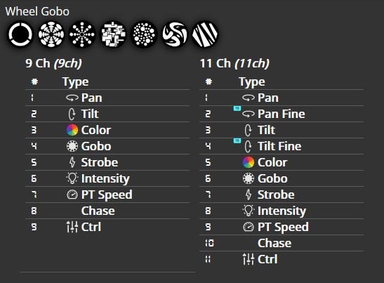

Please anyone have the .pff file for this moving head .
Thanks
fixture .pff for Eurolite LED TMH-17

Re: fixture .pff for Eurolite LED TMH-17
Attached is my attempt.
Please test and provide feedback.
NOTE: The profile was created using V 7.1.1 of the Fixture Creator. This is the version that ships with Freestyler version 4.1.4. The profile will probably not work with Version 3 of Freestyler.
After you select the instrument click on the Freestyler menu item Window -> All. This will open several helpful programming windows.
Eurolite_TMH17.pff- (132.13 KiB) Downloaded 138 times

Hi, thx so much for this fixture.
I had a little problem tho, wich was that it wouldt go from 0-255 but rather soomething in between.
I just changed some values:
Reset Ch. ==> 255
Strobe, off ==> 0, [low, mid] high ==> 255 (cause at 255 its an ooopen shutter again, wich i thought might be nicer to woork with)
intensity min ==> 0, max ==> 255
gobo rot. 1 min ==> 0, may ==> 255
hope that helped someone
