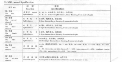

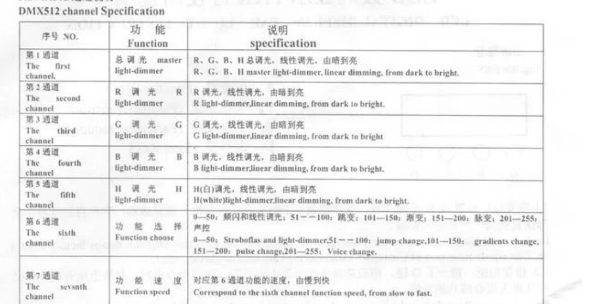

Hi all. I have a couple of Chinese 7 channel RGB Led Pars with the following configuration
CH 1 - Master Dimmer
CH 2 - Red
CH 3 - Green
CH 4 - Blue
CH 5 - White
CH 6 - Macros
CH 7 - Speed for Macros
I'm having a hard time cofiguring this fixturein Magic 3D. Ghannels 1 to 4 are no problem. I haven't got to make CH 5 to work propperly, no white beam is displayed. CH 6: What effect type should I nuse for this channel?. CH 7, it is self explanatory, I've chosen "speed" effect type and it shoud work for CH 6 if it is popperly configured.
Please fing attached the fixture in M3D in .ssl2 format and a copy of the fixture's channel configuration taken from its user manual.
