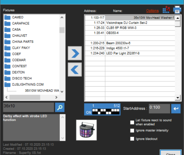

EDIT:
the correct loading of saved chases from a Fixture 'X' depends on the position of 'X' within the 'add/remove fixture' window. I've made all chases in seperate locations, where only one fixture was present and it was always in the first column of the window. So the .chs files for 'X' are working only, when 'X' is in thee first column in 'add/remove fixture' window.

EDIT:
