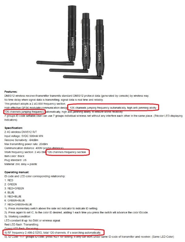

Hello fellow Freestylers! Has anyone gone wireless yet with the new wireless dmx "sticks" ? I want to purchase some, but I heard thru the grapevine that they won't do a full universe. Does anyone know that for sure. It doesn't say anything about it in the specs, except it is 126 channels of "frequency switching". Screen shot below.
One would think if you Google that, you would get 10,000 hits on the subject, but I couldn't find anything to say yes or no. Please help! Thanks, Tim

My understanding of the 126 channels in the documentation is that the wireless device can communicate to the transmitter on any of 126 different frequencies. This is a feature to avoid interference from other wireless devices.
It states it supports DMX512 so all 512 DMX channels should work so it should support a full universe.
It may also be possible to support multiple universes by using the group ID code and a second transmitter but you would need to throughly read the documentation to be sure.

Thanks Ron. This supports my thoughts as well. I'm gonna order these and try them out. I'll file a report as soon as I have thoroughly investigated them.

Hello, just a comment, I have about 15 of the lixada wireless dmx sticks you have in the photo, and they are amazing, and I can use them for all 512 channels. and doing some complicated stuff (fast chases, about 35 fixtures) sometimes I have notices the transmitter gets a little funny and needs to power off and power on, but for the most part they work really well, and now I could not live without them

oh yes, and I have used 2 transmitters on different universes and it has worked well
