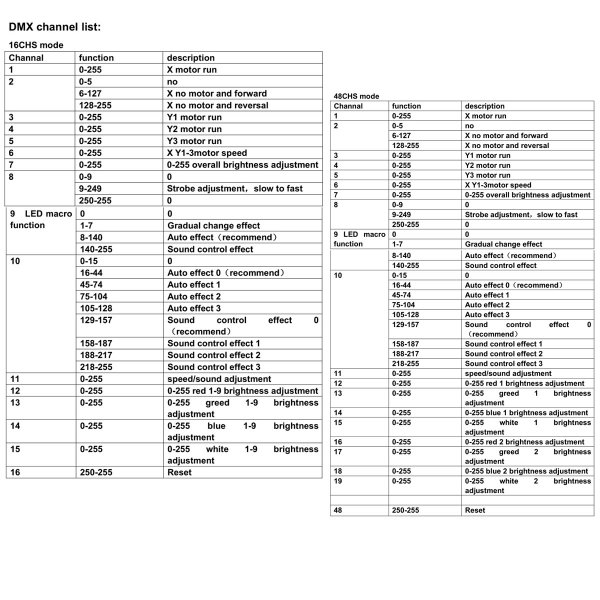

I can configure a fixture for the 16 channel mode.
I guess that, in 48 channel mode, channels 20 through 23 control the number 3 red, green, blue and white. So far I have not figured out what channels 24-47 control. Can you enlighten me? If so I can probably configure a fixture for 48 channel mode also.

Im really sorry but these pages are the only ones I have from the manual. I would be really regretful if you could help me out with the 16ch setup.

Flouren Mini 9 16chan.pff
(11.81 KiB) Downloaded 36 times
This is my first pass at the 16 channel fixture.
Please test it and give me feed back so that I may improve the fixture.
Looking at the 16 channel chart, many of the channels have ranges; just from the chart I don't know if these ranges are "on/off" or whether they control a range such as speed (or something). For example, channel 2 values 6-127 says it is X no motor and forward. What does that mean?
Channel 6 (I think), 7, 8 and 11 through 16 seem obvious that the values are a range and control speed / intensity, etc. The others are not clear, at least to me.
If you look at the macros I used the same graphic for the 4 sound control effects (channel 10). This was the only graphic in the Freestyler library. I will create better ones but wanted feedback first.
If you are willing to do the testing, I will create a 48 channel fixture. You will need to experiment with channels 20 through 47 and tell me what they do. Once I have that information I can significantly improve the fixture definition.

Works perfectly! I would be willing to test the 48 channel fixture.
I tried the channels 20-47 with ESA DMX stand alone interface and no channel seem to work.

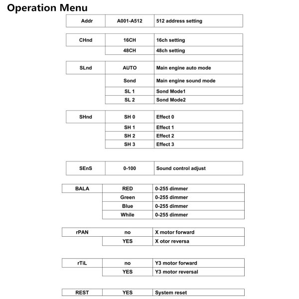

Did you remember to change the configuration of the instrument via its control panel. If it is set to 16 channel mode it will ignore channels 17-48

12-47 Controls light of every single one beam.
12-red
13-green
14-blue
15-white
this pattern continues until 47
48-reset
