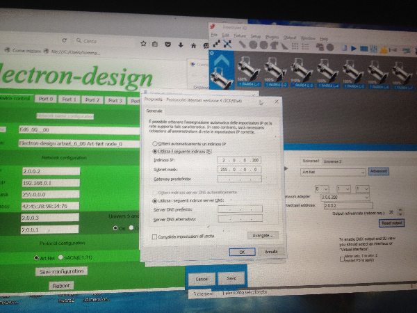

And the net / subnet / universe (3 drop down boxes in freestyler) exactly match the settings under the port 0 tab in Artnet device setup (or whichever port connector you are using)?
I ask because I have seen that device before, and know the defaults were 0/0/0 for the first dmx output (port zero), 0/0/1 for the second, etc and you have selected 0/1/1 in your screenshot.
tommyfree
Re: artnet setting
Post by tommyfree »
ok now it's start to work at least I got a kind of connection..
the artnet led flashing very slow and the lights on visualiser connected via dmx keepon strobing..
but at least we got a result
I think I need to match some other codes,..
thank u anyway
