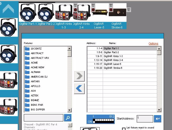

HI, I have an issue with programming the Chauvet Gigbar. I am very new to Freestyler(less than a week) but have some basic DMX knowledge. I haven't found a Fixture profile for the Gigbar so I made one. The gigbar has 6 different lights in one unit. I made the profile as suggested in the tutorial, setting address for each light. Instead of doing 1 20channel light, each light is broken down to how many channels it has. Just to clarify that I did this right when setting up Par1 for example, I put that it has only 4 channels, not 20. Par2 I uses the same profile as Par1, but the starting address is 5-8. For the Derby I put 3 channels, but starting address is 6 etc..
Par1 ch1-4
Par2 ch5-8
Derby1 ch6-9
Derby2 ch10-12
Laser ch13-17
Strobe ch18-20

I'm new to Freestyler and I'm trying to program the Chauvet Gigbar as well. I can control Par1 and Par2 but I'm not sure how to program the Kinta (Derby). I was wondering if you can upload the Derby1 profile here. Attached copy of Par1 Profile, as you mentioned above, I use exactly the same profile for Par2. Then, in Freestyler assign channel 1-4 to Par1 and channel 5-8 to Par2. Any help will be appreciated.

My bad! Attached all fixtures profiles, in pff format (6 in total). I added all fixtures following the procedure mentioned above (see pic... Thanks DJBrent!) and all lights are working now.
DJ Perez
