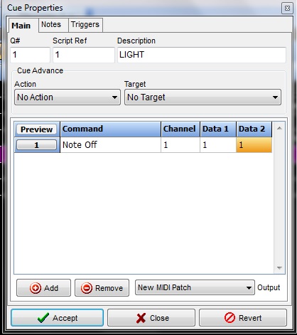

I am running a theater with freestyler and I am trying to send MIDI command from another software to Freestyler. I installed an internal MIDI Loop application to enable me to send MIDI to Freestyler. But it does not work. I also attached the interface for the cue playback software ( Multiplay).
Would you please help me, how to add the note into the midi interface of Multiplay and FS.

hi first off all for freestyler you have the add-on GOmonkey and its a Theater cuestack..
but back to your quastion i assume you know how Midi works..
But you use a NOTE OFF command i would use a CC# or Controlchange.
Data1 is the NOTE (or identical button/slider) from 0 to 127
Data2 is the Velocity (or Value that the Note can have) if you use a Slider this can be incromental from 0 to 127 and if you use a Button OFF=0 and ON= 127..
/spirit

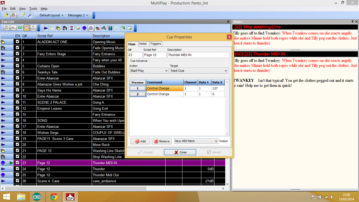

I used multiplay at xmas for a small amature theater production and it worked great, using loopbe as the midi loop back.
reason i used multiplay over go monkey? i was mainly doing sound and sound effects with the odd lighting effect. The majority of lighting was still on analogue dimmers.
Will be adding audio capabilities to goMonkey for this years panto.

I had just found out how to do it before I read your reply and your image confirms how I did it. I added the control change with velocity 0 to every midi cue in multiplay because if I didn't FS would react only once to the midi sent from Mutiplay. A second start of the same cue triggered from multiplay didn't do anything.
I had to get back to version 3.5.2 of FS though
to make it work. When I try the same in FS 3.5.5 (latest version), I don't get any reaction at all. Is there something extra to do in FS 3.5.5 to make it work ?
