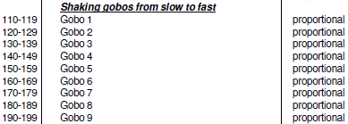

oke What does the Formula do This is realy nice if you have a Gobo Wheel with a shake function (Or something like it) and it looks someting like this
(9.47 KiB) Downloaded 3 times
you see
gobo1 slow110->119fast
gobo2 slow120->129fast
gobo3 slow130->139fast
and on........
now the old way if you want to have all the shaking gobo's to have a Slow ,med, fast button you need to make 9x3=27 differnt buttons.now whith the Formula you can select a Gobo from the Goboindex Lets say Gobo1Value110 now you press the Frist Macro formula(slow) CH1=(GI1*10)+3 and the value from gobowheel1 change to 113 (110+3)
oke second Macro formula(med) CH1=(GI1*10)+6 and the value from gobowheel1 goes to 116 (110+6)
third Macro formula(Fast) CH1=(GI1*10)+9 and the value from Gobowheel1 goes to 119 (110+9)
know if you select gobo2 value120 and press
First Macro formula(Slow) CH1=(GI1*10)+3 and the value from Gobowheel1 goes to 123 (120+3)
Second Macro formula(Med) CH1=(GI1*10)+6 and the value from Gobowheel1 goes to 126 (120+6)
third Macro formula(Fast) CH1=(GI1*10)+9 and the value from Gobowheel1 goes to 129 (120+9)
so at the end you only need to make 9+3 differnt button to reach the 27 differnt possibilities.
