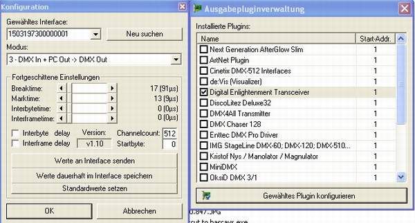

For my new purpose I want to use also the DMX IN port of my interface in combination with
freestyler.
Unfortunately freestyler ignores the DMX IN signal, that comes from my IMG Stageline 1440 desk.
--- To be shure the Interface works correctly, I installed DMX COntrol (That I don't like much so far) and
it provides the possibility to chose the mode for my interface ----
I have the strong feeling, that freestyler brings my interface to a special "output only" mode, when the dll is loaded.
Can anybody help me to embed the Digital enlightenment IF 100% to freestyler, that I can use my desk and the PC ?
