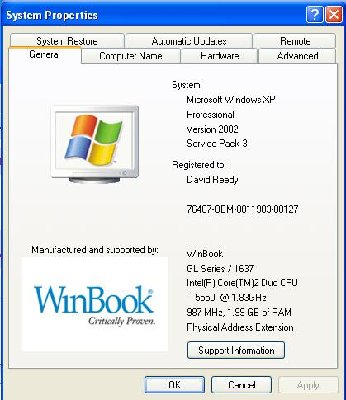

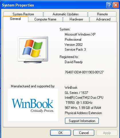

Alrighty, here is the computer im using
it freze on my computer whenever i click in the text box for the filename. i can change directories, subdirfectories, etc.. its just when i click on the text box for the filename is where it freeze up.. weird huh?You do not have the required permissions to view the files attached to this post.

What version of FS are you using? How much freespace have you got on your hard drive? Are you running any other apps at the same time as FS?
Its hard to see from the picture you uploaded so how much memory have you got?
