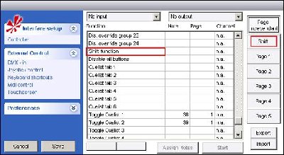

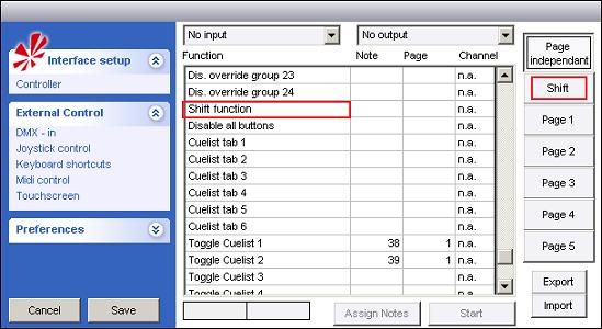

is there anybody who knows what the "shift function" for midi is doing?
there is also a "shift" button at right side of the midi control window in options, see attached picture. what is that good for?

Im not sure how to explain this clearly,
On Midi controlers you may only have a set number of faders, buttons etc.
So page's where introduced so that changing the page changed the function of all the buttons/faders.
The shift button only changes the function of faders/buttons that have an alternative shift function for as long as the shift button is held down.
much like the shift button on your keyboard.

ahhh, i seee. i did know about the pages but I did never found out how the shift function worked,, nothing happens if a pressed the assigened button
thats actually a great feature, makes my job a lot easier
